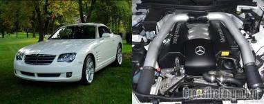

If you are talking about the cover pictured below, then MB had a tube running from the TB to the air cleaner on the E320's this come off of.
You should only use this cover if you have a single or dual CAI kit.
IMG 0980

Pictured in IMG 0980 is my engine with that cover and a NeedsWings single CAI.

If you use that engine cover you are obliged to use the setup shown in the picture, the filter is out of site in front or the radiator.

MI1xfire has the set up I like. I was just wondering where he got the parts. I would like chrome pipes though. I have the same cover

You can buy a bunch of parts and cobble one together, but the rub comes where you need to mount the IAT/MAF sensor, unless you retain the 2 OEM plastic pieces and attach the tubing to that.
Some members, like maxcichon were very successful with that approach, but then his doesn't allow for that engine cover : https://cimg4.ibsrv.net/gimg/www.cro...a936b18f36.jpg
