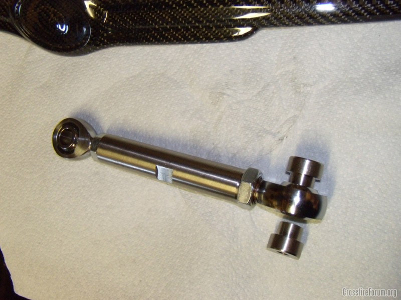

BlackSRT6.... yes, the rod ends are right and left hand threads. Loosen the jam nuts and turn the rod to adjust...re-tighten the jam nuts
the adjustable arms are $235/set and the sway bar links are $175/set.... 10% discount if you order any 2 or more sets....

I wasn't feeling the love for the bottom mount of the sway bar link and did some test fittings and found that I can use a QA1 rod end and spacers like the other arms.... so I have revision 2 and I am very happy with them.....I had the other sets ready to go out but am going to re-do them with the new design... I just need to get more rod ends to match with the other end.... this will also double the adjustment length from 3/4" to 1 1/2".... here are pics of them and my stainless ones.....
Les.... I will send you the new parts..... you will just need to screw them onto your existing top rod ends....

Go to QA1 and look up the specs on the XM10 rod ends.... they are .75" ***** with a .625" hole... the spacers take the hole to 12mm to match the factory bolts and 1.5" wide to match the mounts...
